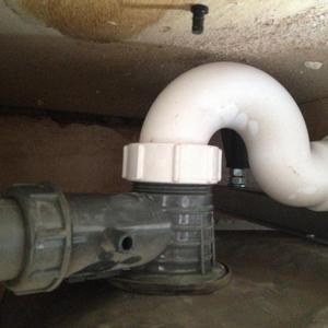

    What's this hole/vent for?
    Yes, not sure why it's upside down! Grey pipe is bath overflow. What's this outlet for?
  2. A
    Hey Had a leak under the bath, turns out its water spouting from a little outlet on the waste pipe. There's a rubber bung that had popped out, though it seats very loosely so no seal. I'm sure it's simple, but what's this hole for? Can't see it on any other pipe images online, and not sure...
