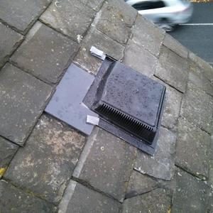

    Have these slate vents been installed correctly?
    I haven't paid for the job yet. Is the fibre cement tile acceptable or should I ask for a replacement slate as well as the vent installed underneath the slates?
  10. D
    Hey, Had a roofer around this week to point some flashing and fit some roof vents as we had some condensation under the eaves. I inspected the vents via velux windows in the loft. He seems to have broken a slate and replaced it with a section of vent tray and fitted the vent on top of...
