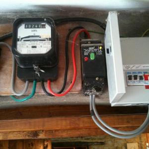

Thank you for the replies much appreciated. I now know the difference between an active and passive RCD amongst other things. I also get the general concensus that "it" could be better.
Having read about ELCB's I think the one I have is a current one which means its an ELCB by name because of...
I'm lucky as I only have two MCB in use and they don't trip when the power fails. Something which does effect my neighbors. Thing is one supplies the shower and the other supplies the lights and sockets. Difficult to see in the picture but the third is marked as free.
If I replace the CU I...
I live at the end an overhead feed in a rural location and hence have an earth rod. Attached is the current setup which as you can see is not exactly complex. Our only source of hot water is a 10K shower in the downstairs bathroom. Also I'm not sure what edition everything was installed under...
