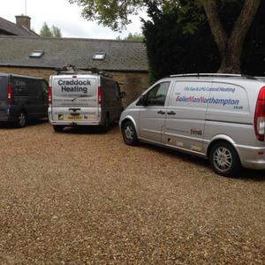

    well thanks for a constructive reply. Things get out of hand with irrelevancies so quick. The picture (it appears I foolishly posted) is nothing to do with anything other than the type of boxes used in my end of heating. The point was to show the scale of box to those offering very large & long...
