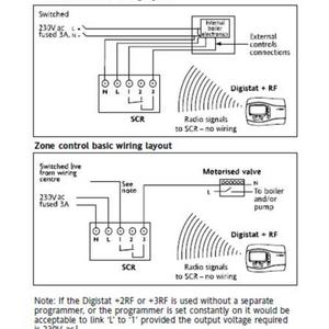

    CH wall thermostat swap - wiring question
    no. Question was is it ok to link L to 1 - while i apprechiate the feedback no-one has given my an answer as such. I interperate Securespark's feedback as a question to confirm what i want to do, not a yes/no it is ok to do that which is what i'm asking. Apprechaite any furgther comments...
    >You are linking L -1 are you? That the question yes, I think the install doc is saying thats ok but wanted to check with the pro's >This SCR unit is presumably not going where the stat is at the moment? It is yes, I dont see a need to move it, its out of the way as is and the control...
    Hi, I want to replace an old Dryton wall thermostat with a new 7 day programmable version and need to check the wiring with you guys. The current thermostat is a Dryton RTS1: Standard Model, it has neutral, live and call for heat on pin 3. The boiler has a separate 24 programmable clock but...
