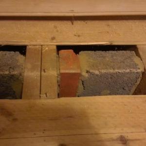

    Wall growing up through floor!
    Many thanks for the replies. After trimming down the blocks and bricks, do I need to ensure that when I fill between the beams/joists that the bricks/blocks are wedged tight inbetween as they seem to be now and do I need to worry about mortar or anything like that? Thanks again.
    HI In an upstairs bedroom, I noticed the floorboards are not all flat. There are two lines of "humps" where they had been pushed up. I removed the floorboards on one of them and found underneath the top of a block wall that the joists are seemingly resting on. The problem is that top of the...
