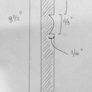

    how would I route this?
    hi all many thanks for the multiple suggestions on how to deal with this, and the recommendation for the cafe! I only need 3 or 4 metres so I think I'll try gregers suggestion using torus skirting. thanks again all.
    hi, trying to repair / renew skirting. Need to find skirting like this, or get a router bit to cut the bead. Would appreciate any advice. Thanks.
