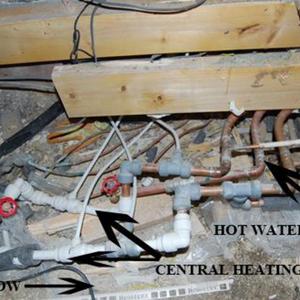

    REMOVING PLASTIC PIPES AND RADIATOR
    Hi I have a couple of questions about some pipes in bathroom area. I have attached a pic to help. I want to remove the radiator and plastic radiator tubing connected to the 22mm copper heating pipes as seen in the pic. The drain valve runs out of the pic to the outside wall. I dont want to...

    replacing plastic pipes with copper
    the radiators and towel rail are all plastic pipe as well as the pipe going to the sink and bath and they all look to connect to each other in this mess of pipes. And not one single pipe has any ident marks or even a hint of direction ar usage. As i said the old water turns of asily from an...
