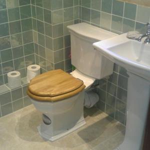

    Hi Everyone, I couldn't find a previous answer that directly answers my question.... I am fitting a new Toilet. It is an Imperial close coupled model (Westminster). The waste outlet from the toilet faces the back wall of the bathroom. The waste pipe from the stack pipe is horizontal...
