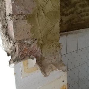

    Cheers speed, bonding it will be. This is the depth of the existing plaster: So I guess do it in two passes. Any tips for the concrete lintel?

    Render vs Plaster
    According to the plaster selector guide on the BG site, max depth for bonding is 11mm so render it will need to be. So final problem- how to render over the concrete lintel?

    Render vs Plaster
    The brickie has raised the lintel on the chimney breast, ready to fit an extractor fan. I need to patch in the plaster & have a few questions. The house is Edwardian & the existing finish seems to be some sort of render with a skim of plaster. On the sides of the chimney, the render is around...
