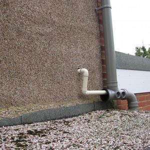

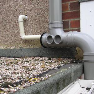

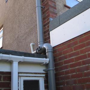

    Adding shower & Toilet to new stack pipework, combined s
    I dont recall if it was "as is" now when the bco last came round as it was quite a few months ago now. The builders remit was to leave me with a vent stack that could have a toilet and wastes connected to later and drains then tested as I didnt know what layout I would be having in the...

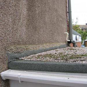

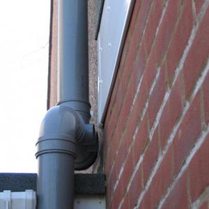

    As part of a kitchen extension job on a building notice was the refurb of my bathroom which needed a new soil stack to get the pipework out of the way of the new kitchen extension. As I have a downstairs loo there was no problem removing the upstairs toilet for some time while the ketchen...
