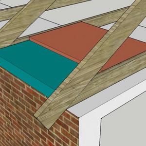

  5. R
    Ceiling condensation in bedroom
    Download google sketchup (really easy to use, that image took less than a minute). Then just screen print and crop.
  6. R
    As woody says, likely cold bridging, I assume that purple wall is external. Haul yourself into the loft, and see if there is insulation missing there, or if it coincides with a joist/rafter (the stud "could" act as a cold bridge, but more likely there is a gap between the joist and the...
