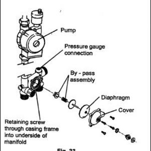

    Thanks guys. I've made some major progress. I got a new diaphragm and took the flow switch off and replaced. The old one was not too badly worn. After a lot of fiddling and working it through, I got to the bottom of the problem. As Agile said, the flow switch is backwards, it pulls in when...
  8. S
    Vokera Mynute 20se - Boiler keeps turning on when not needed
    Thanks again. Can I just check with you, is the "diaphragm" the little rubber part you refer to the in this diagram? It is on page 29 of the service manual, http://vokera.co.uk/wp-content/uploads/2009/04/mynute_10se_14se_20se_installation_and_servicing_instructions.pdf If so, it...
