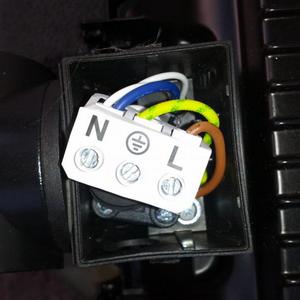

    Replacing a PIR Light
    The new lamp also has an override facility but only has two connections. As far as I can tell, the wires in the existing override swich are Red to common, Yellow to L1 and the Blue (incorrectly specified as Brown in the original post) going to L2
  6. S
    I need to replace an existing outdoor PIR security light. However, the existing light has four wires going into it but the new one only has three. My problem is working out which ones to use. The old lamp has a Brown and Red going into a block and a Yellow wire going into another block plus the...
