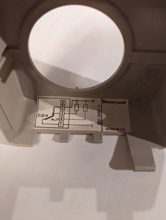

We have an old Honeywell room thermostat - not sure of the actual model but this is a picture:
It was working ok - we are just about to decorate the room and decided it would be good to replace it with a more modern looking one.

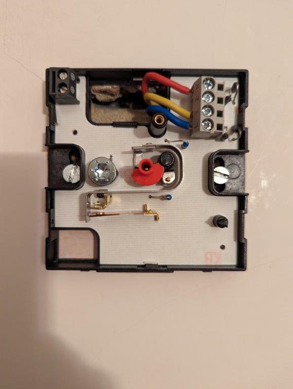

I disconnected it from the circuit and made a note of the wiring. The colours seemed a bit wrong but it worked and so assumed it must be right.

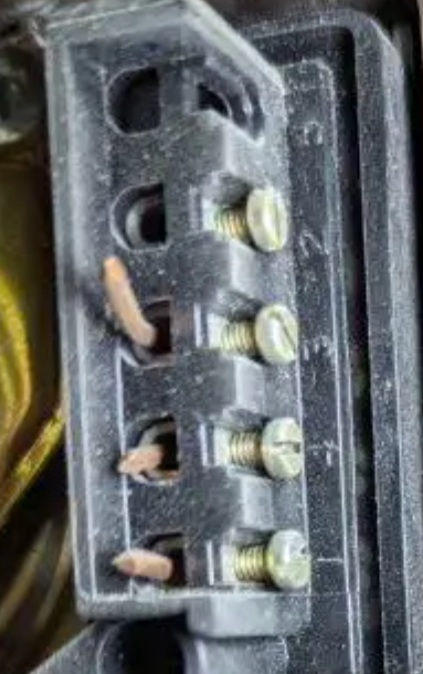

Note wires are only connected to 1, 4 and 3 and looking from the back we can see the colours:
So Blue is on 1; Yellow on 4 and Red on 3
Looking on the diagram inside the cover, we can see that 1 is Live; 4 is the switched Neutral and 3 is the Neutral.
This is where I think the colours are wrong as I would have expected Red to be Live but it works so must be correct.

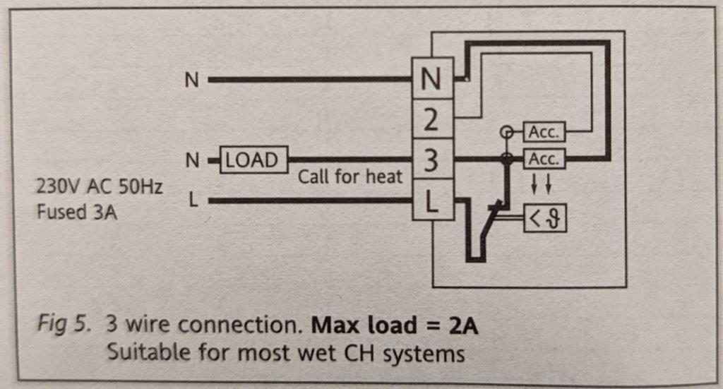

I intend to replace this with a Drayton Combi-stat RTS8, the wiring for this is:
So, I connected the Red wire to N; Yellow to 3 and Blue to L. Turned on the power and when turning the dial right up to 30 nothing happens - the boiler doesn't fire.

Those original wiring colours are definitely confusing, and the schematics aren't much better! :)
I'm afraid your assumptions are incorrect.
Your original stat is connecting together terminals 1 (Blue) and 3 (Red), when it is calling for heat.
1 Should be Live (currently Blue)
3 Should be Switched Live (N/O - currently Red)
4 is an optional switched Live (N/C - yellow)
(In practice, with this setup, it doesn't matter which way the live and switched lives are connected)
You don't appear to have a Neutral at all; that would have been connected to terminal 2.
However, it would be worth investigating where the other end of this cable is connected, to give a definitive answer (if these are all switched or live wires, I wouldnt have expected a trip).
For now, you can try and connect Red to L, Blue to 3 on your new stat and keep the yellow safely isolated in a separate terminal block.
Then see what happens.
Edit:
Actually use Blue to 2, as per Drayton's two-wire spec.

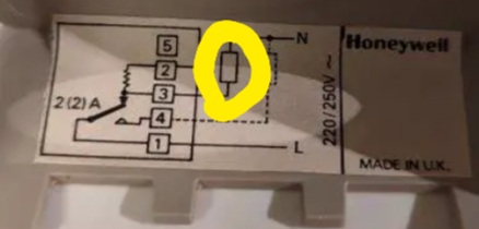

I'd have thought 1 is Live, 2 is Neutral (for the booster heater), 3 is Switched Live (to load). 4 is Live when the stat not calling, but isn't used here.
In Figs 5 and 6, I assume the thin line round the outside represents the outline of the box, not a wire, or it would be a short from L to N. Confusing or what?
Yes, correct, but in this case, 2 (Neutral) isn't being used..
Yes. But what is more confusing (and what I've seen plenty of times before on here), is the schematic showing a nameless 'box'...
Many, as with the OP can see the N and don't realise that the box represents the boiler/load, with neutral connected to one side and switched live to the other.
And so we get the mistaken ...
Yes, I hadn't noticed that. So the booster wasn't being used, giving in theory greater hysteresis.
That's right. Calling it LOAD in Figs 5 and 6 helps, better to show a part dotted wire, to indicate it's remote.
