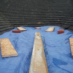

    Flat roof between two hip bay roofs
    Many thanks for that nosell, it makes sense now. Well, what can i say.......what a wonderful forum this is. My sincere thanks to Noseall, Tuck1 and Surrey roofing estimator. Ply is ordered should be delivered tomorrow, have stripped back the tiles today, should be a nice warm day...
    Sorry guys, i know i keep asking but after fitting the ply up the rafters do i need to re batten across for the tiles to hang too, only its in my mind that should any water get behind the tiles onto the sarking any battens across the ply will stop any water running down the roof pitch. Thanks...
    Thanks Tuck 1 for your reply. All points noted and yes i agree with your views on felt, i have recently helped a friend fit a rubberised roof covering to his garage and was suitably impressed with its ease of use, finish, and looks. I have also considered fibreglass as an option as per...
    Thanks Noseall, all clear and understood. Especially the bit about the cocking fillet, makes sense now you have mentioned it. Whilst on the subject of lifting the last tile row, i did think about trying to get some sort of flat bottomed guttering to sit around the edges of the flat roof...
    Many thanks for the reply SurreyRoofing Estimator. I'll go with 12mm then ! And thanks again for the advice on the height, just need a slot with some good weather.....looking reasonable from Thursday. Also if i may, is there any other advice where the boards laid on the rafters meets...
    Hi all Firstly thanks for any replies. I am part way through extending my porch , all done via local B.C.O as part of a larger extension to our property. I am moving my porch forward by some two metres between two hip bay roofs on a bungalow, by constructing a flat roof between the...
