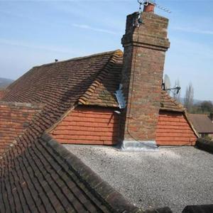

  12. I
    Mixed roof, pitched & flat what insulation levels apply?
    Hi, we have an ongoing saga with regards to trying to fit a large (2100x1400mm) skylight into an area of flat roof over piched sides above an existing double story extension. We originally wanted an open shaft through the roof void (approx 1000mm) to the room below but as the construction is...

    Hi, we have a detached house which had a double story extension consisting of a double garage with room over capped of with a flat roof. Just to make it clearer the flat roof is raised about 3 to 4ft over the ceiling height and has trusses. We would like to have a skylight fitted in the flat...
  17. I
    Is a skylight possible with our flatroof design?
    Wow thanks for those two options guys, the diagrams certainly do give a good idea of the possibilities. Just to give an idea of scale the truss spacing is at 500mm and the internal room dimensions below are 5.24M from chimney wall to far wall (both load bearing) and 6.46M across (i.e. inline...
