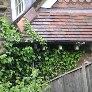

    Thanks for your patience! yes, the roof of the dormer is flat - it is very small, about 6-to 8 sq feet I would guess (I'm a girl. I'm pretty poor at guessing measurements :-) These facts may or may not be related ). As you can (almost) see, the dormer window is 3x2 "georgian" panes and...

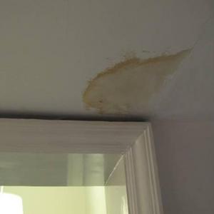

    thanks for the suggestion - you're quite right - an image would help. This is the best I can manage I'm afraid .. sadly. sorry, not easy as I'm currently living in a different country. all I have is this piccie sent by tenant of the damage , which is prob completely useless... and one of...

    Hello - can someone please advise? I have a leak at one upper corner of small dormer window (very easy access). Window is about 3 feet by 2 feet, if that big Repairs proposed suggest (in as few words as I can) remove tiles and existing covering, check condition of decking (what's...
