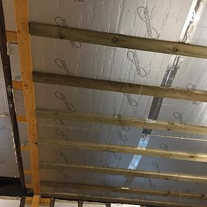

    25mm PIR board run across underside of roof joists, then 4x1 battens fixed thought shims to the joists. Plasterboard will be attached to the battens.

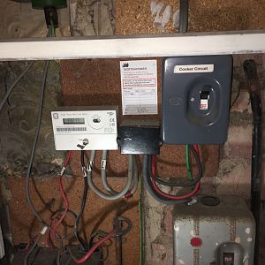

    Looking for some thoughts and advice on a mess of old wires and stuff (need to find out names as well!) Its an old Edinburgh Victorian town house thats been split into two flats in the 1950's. I own the upper flat. The photo 1 shown below shows the wiring in the shared entrance hall...
  15. Photo 1
    Photo 1
    Its an old Edinburgh Victorian town house thats been split into 2 flats in the 1950's. The supply from the street comes in the bottom left. The GF flat is fed by the thicker red and black cables, that go into copper conduit, down the the bottom left of the photo.

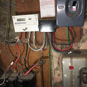

  16. Photo 2
    Photo 2
    My flat (upper floor) is fed by the smaller red-black wires, that feed into the white meter. This was installed circa 2009 I think.

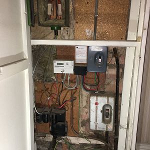

  17. Photo 3
    Photo 3

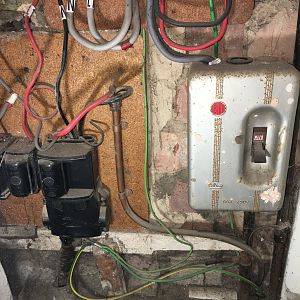

  19. Photo 5
    Photo 5
