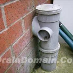

    Hi all, I'm putting in a new Soil stack for my new ensuite. My soil waste is dropping from the garage on a horizontal run in the ceiling (with the correct drop of course) and then straight through the wall into the stack. I would like to connect is straight into the stack avoiding the...

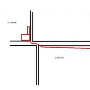

    Thanks for that...it's like that drawing was made for my job. The dimensions are very similar. Would you recommend a multiquick flexible extension. The poster higher up didn't seem keen. Cheers Jon
  12. J
    Soil Pipe question
    Yes well aware its Building Regs. Paid them already and had Mr inspector around before I did so. They're in agreement with where I plan to put the new toilet and the path I plan to run the waste pipe. The whole reason I'm dropping it into the garage (rather than carrying on under the floor)...

    Hi all, I'm putting in a new en-suite. This is going into a box room at the front of the house, but in the middle. I need to put in a new soil stack as the existing soil stack can't be reached. The en-suite room is almost above the garage. My plan is to run the soil pipe suspended in...

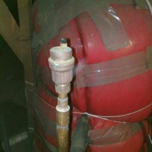

    I'm tempted to leave it unless otherwise advised, as the screw cap (the black bit in the picture) seems to stay firm fine now I've screwed it back on all the way. I'm just worried it has worked its own way off with pressure and that it'll happen again.
  19. J
    Leak in loft - advice please
    Hi all, I moved into a 1938 house about 8 weeks ago. The house suffered a burst pipe in the loft 2 days before we moved in which was fixed. We have been doing work in the dining room which involved taking a radiator off and draining the system down. This was a few days ago. This...
