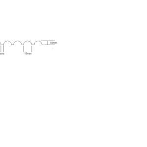

    10mm half moon trowel.
    Just want to make sure I've bought the correct adhesive trowel for laying 610mm x405mm x 12mm thick travertine tiles to plasterboard walls and marine ply floor. I've been advised on here I need to use a 10mm halfmoon adhesive trowel which I presume mean't 10mm deep notches The notches measure...
