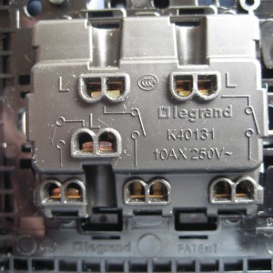

    Success ! Thank you. Should I put a block on the spare black wire or tape it up or something ? Can you also explain the yellow circles you highlighted and which of these connections I should consider as L1,L2 and Common ? Everyone seems to talk in these terms and I can't make the link of my...

    Ban-all-sheds, what the back of the switch unit shows me is terminals for live and an indication of switches. I believe I have one live, red, wire. I know I have 2 sets of red and black wires. I know I can get one set of wall lights to work via one of the switches on the new 3 gang switch unit...

    In case the pic is not good, the new switch does not have L1,L2 or common shown on the back. 3 connections are identified as L and the other 3 are not identified. Given that this is a 3 switch unit, there are 2 terminals for each switch, not 3. This was purchased as a 3 gang 1 way switch, which...

    I have connected one red wire to an L. Its partner black wire to the accompanying unidentified connection. I have done the same with the other set of red and black wires. This time I have also made a bridge connection between the 2 red L connections. One switch works it corresponding wall light...
