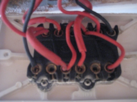

I am seeking to change a 4 gang wall light switch to 2x2 gang light switches next to each other. I am assuming that the 4 gang has a single power supply, so it might not be simple, for a mere DIYer, to make this mod. I would appreciate guidance how I can achieve my goal. Thanks, in advance, for advice offered.
The existing 4-gang may or may not have a single feed; there are numerous ways in which it may have been wired. A picture of the existing arrangement would help.

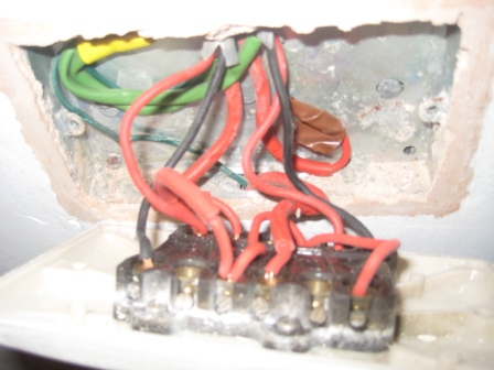

I have attached a couple of photos, as requested. Hope they help. I want to change to 2x2 as I want to have toggle switches with period style switch covers, which are not available as 4 but only as 1 or 2. 4x1 is not an option.

Before you remove any wires, make absolutely sure you label them securely and unambiguously, and make a note of where each one goes.
Bear in mind that your existing switch has its terminals arranged like this (or the other way up) and an replacement switch might not invert every other gang and/or might use different labelling for them, C-L1-L2 vs L1-L2-L3 vs L-L1_L2 etc.
If you don't transpose the wires to functionally equivalent locations it won't work.
Do you realise that two single switches will not fit on your double back box?
You will have to change it for a DUAL back box.
Would much more recommend two 1-gang boxes spaced a bit apart. Even if they fit (eg flat plate ones probably won't), two accessories on a dual box invariably looks sh*te.

There are no internal connections between each gang. Whether you have 1x4G, 2x2G, 4x1G, 1x3G+1x1G or 1x2G+2x1G, the wiring of them is identical.

As they currently are.
You have 4 switches combined into one lump with a total of 12 terminals.
You will have 4 switches combined into two lumps with a total of 12 terminals.
