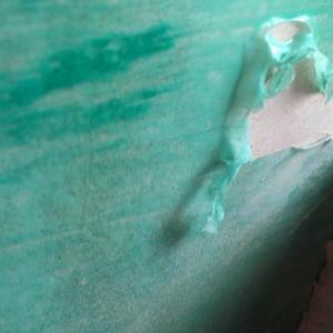

  3. C
    HELP!!! Paint has pealed off celling very easy
    Hi Today I sanded the celling with 120grit using my sanding pole and it seem via flakey and dry when sanding and did not feel smooth so I wonder if there was not any PVA on it and someone just did not paint the first coat correct last time. For miss coats of dulux is it best to do 50/50...

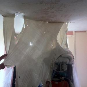

  10. C
    Hi all, I was stripping some of our walls in our bedroom and noticed the paint on the celling started to form large bubbles so I thought this was not right and started to pull it away. The whole lot pulled of the celling with no force at all. I think the other person that had the place...
