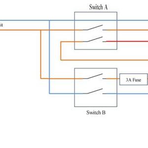

    Double plasterboard on internal stud walls?

  5. R

    Ok, think I'm narrowing down my options. One last question: can you have a switched FCU inside a cupboard (under a basin or inside housing for toilet cistern and macerator) inside a bathroom? That's the last easy option... To answer yours: The light switch will be at normal height...

    Thanks very much John, I see what you mean. I'm just thinking of safe operation, rather than maintenance. I'll have to re-route it all off the lighting circuit. I was going to put the FCU down at knee height under a desk in the next room though, which is going to use a lot of cable. Are...

    Yes, the fan manufacturer's instructions were for a double pole FCU before the live and switched live divide. The FCU on the original diagram is intended to satisfy this. Which regulation would my original design break? I can run it all through the lighting circuit but it's a real pain to...

    I've got a bathroom fan with a timer. The best place for a 3A isolating FCU is very near a ring main, but I'd like it to be controlled with the lightswitch, with a switch next to it offering over-ride of the fan. This will work electrically: But is it ok with regs? Will they be ok...
