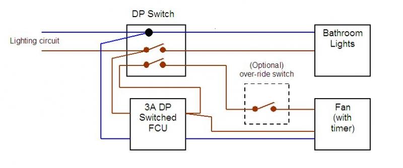

I've got a bathroom fan with a timer. The best place for a 3A isolating FCU is very near a ring main, but I'd like it to be controlled with the lightswitch, with a switch next to it offering over-ride of the fan.
This will work electrically:
But is it ok with regs? Will they be ok with me putting a ring main in one pole, and the lighting circuit in another pole? I could power the fan off the lighting circuit but it'd be an extra, long, fiddly run of cable. Much easier this way.
Do you think this will get signed off by Building Control's electricians?[/img]

What purpose does the 3-pole isolator serve, given that both its L ad S/L feeds derive from the same output of a dedicated DP FCU? I suspect you may say that it's to satisfy the fan's MIs to the letter (if the MIs call for a 3-pole isolator), but surely a DP switch which supplies both L and S/L is functionally the same as (and as good as) a 3-pole one?

Yes, the fan manufacturer's instructions were for a double pole FCU before the live and switched live divide. The FCU on the original diagram is intended to satisfy this.
Which regulation would my original design break? I can run it all through the lighting circuit but it's a real pain to cable.
Is there a separate problem with giving yourself a manual override of the fan's timer by putting the neutral on a single-pole switch as well? It's for an en suite and if you go for a pee in the middle of the night it'd be nice not to have to wait 15mins for the fan to shut off...

It is potentially dangerous to have two different circuits using the two poles of a DP switch, since it's an unusual/unexpected situation and would require two circuits to be isolated before one could safely work on the switch. At the very least, the regs would require a prominent notice to warn of the need to isolate two circuits before opening the switch - but, even then, it's not nice, and there might be more specific regs (can't think of any at present) which forbid it. A 'catch all' is that by using a DP switch (probably with terminals labelled 'L'and 'N') in that fashion you would almost certainly be working contrary to the Manufacturer's Instructions - which, in itself, is a violation of the Wiring Regs.
I'm afraid that's a question which is going to get people saying that you don't know what you are talking about and shouldn't be contemplating doing this work. A SP switch in just a neutral is always very dangerous. Think about it ... the live may be switched on but, because of a separate switch in the neutral, the fan won't be operating, so someone could start working on the fan (e.g. to replace it) without realising that there were live connections to it. Indeed, they might even find your neutral switch and think that, because it stopped the fan working, it was safely isolating the fan from power.

It's occurred to me (and probably also you) that, with any of these arrangements, you would need to remember to switch the override switch back on, otherwise the fan will not work subsequently. With most (probably all) fans, you only have to remove the power momentarily to cancel the fan overrun, so (provided you didn't mind the fan coming on whilst you have the ensuite light on) you could switch it off, and then immediately back on, after you'd finished using the ensuite and turned the light off. In fact, provided the light is switched off, it's only the permanent live which needs to be switched off momentarily - so one option would be to use a SP 'push to break' push switch (a 2-way push switch, wired the appropraite way around) in the permanent live feed to the fan - you'd then just have to push it and release in order to 'cancel' the fan over-run.

The light switch will be at normal height outside the bathroom door. Trouble, I think, is that as fan has a timer, it needs both a permanent and a switched live. So as far as I can tell, FCU has to come before the switch.
A triple pole-switch would do for isolation, but it needs a 3A fuse, and I don't think you can get a triple pole-double fuse switch without resorting to some massive custom grid that would be a bit ugly on a domestic wall (and guess it's pretty clumsy electrically too).

Do you have a problem with having the FCU close to the light switch? If not, how about something like:
You could either use the FCU as the fan over-run override, or else could add a separate switch (maybe a push to break switch) as indicated.
...without resorting to some massive custom grid that would be a bit ugly on a domestic wall (and guess it's pretty clumsy electrically too).
In fact, the above could all be done with a 4-unit grid in place of existing light switch - and I don't think that would look too bad at all (I have plenty of grid switches in my house).
