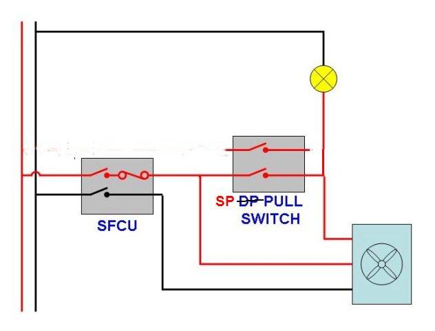

I am replacing my bathroom fan which is currently wired from the lighting circuit via a 3 pole isolator and no extra fuses. The new fan suggests a 3A fuse which I intend fitting in the permanent live feed. This new fan will be wired with a switched feed from the bathroom light for the internal timer and what I would like to know, is it necessary also to fuse the switched feed at 3A otherwise it will be fused as the lighting circuit. ie. 6A MCB.

The easiest way round this situation is to fit one fused spur (with a 3 amp fuse) that serves the whole of the bathroom (ie the bathroom light and the fan). Typically the fused spur would be outside the bathroom, above the door for example.
Anything else is complicated, and requires a double pole switch as a light switch, which can be awkward when trying to match existing accessories - especially a wall mounted switch outside the bathroom.

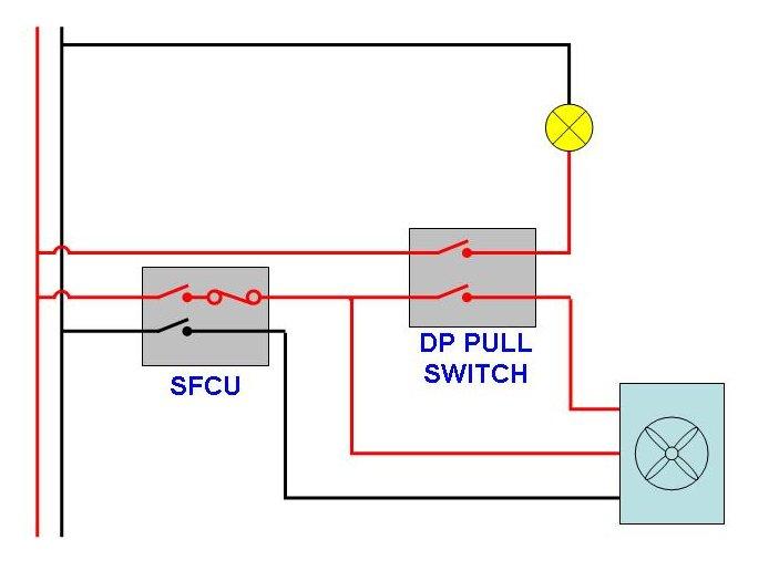

I was going to suggest that as a good way.... :) .... Gets rid of the 3P isolator too.
Do you mean ....
.. if so, I think that probably the only sense in which it is 'better' is that it enables the fan to be isolated without also isolating (i.e. not being able to use!) the light - which I think is a pretty marginal advantage. That apart, if one simply runs the light off the same pole of the pull switch (which can then be SP) as the fan, then one ends up with sparkwright's suggestion...
Kind Regards, John
