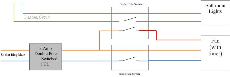

Bathroom Fan Wiring - is it compliant?
don't I what I'm talking about know
I think you're right, there.
The design proposed by the OP would not trip the RCD.
It may not be ideal to have 2 circuits in the light switch, but it does not contravene the Wiring Regulations, nor is it dangerous and unacceptable.
Nor, assuming he doesn't get someone as hard of thinking as you, should he have trouble with Building Control.
You will have seen my previous comments about that. Certainly not ideal. No worse than what happens in many a grid switch arrangement, but at least one is then more likely to be expecting the possibility. A warning that it requires two points of isolation might well be required to comply with the regs, mightn't it? Also, as I said, using a DP switch's terminals labelled 'N' for L could be argued to be contrary to MIs, couldn't it?
Is one, if it's in a house and has switches for bathroom lighting and fan?
It might.
But then so would isolating the circuit to be worked on by turning off the main switch, unless the CU had DP MCBs or RCBOs.

Yes, I think so. The fact that it's all occurring in one switch might merely reinforce the 'expectation' that bathroom lights and fan are most commonly connected to the same circuit. Indeed, until one too the switch plate off, one probably wouldn't expect the 1-gang switch to be switching two different things. Conversely, many multiple grid switch setups are clearly dealing with different things, so there would probably be a much greater awareness of the possibility of more than one circuit being involved.
IMO? Only by someone pathetic.
IMO, too - but people seem to get very literal in their concerns about failing to comply with MIs, even when there is no particularly good engineering (or, sometmes, even common sense) basis. 3-pole isolators for fans is probably as good an example as any - we've seen electricians moaning that they 'have to' fit them 'because of the MIs'.

You seem to have missed the point that it was I who was arguing that one of the reasons why having two circuits using the same DP switch could be non-compliant was that it was probably contrary to the MIs (hence 134.1.1), and BAS who introduced a contrary opinion. In the past, I have repeatedly acknowleged that, frustrating though it undoubtedly is, electricians have little option but to comply with MIs (particularly if they belong to schemes which insist on BS7671-compliance), no matter what they think of them.

1st attempt, I never said it would.
Isolate the circuits using a relay powered by the light switch?
Not sure how it would trip the RCD, however I would think having a socket circuit running into a light switch would be a bad idea unless the light switch has a warning label on it.

But is it ok with regs?
Do you think this will get signed off by Building Control's electricians?
No, its dangerous and unacceptable
Well if BC think his design is ok, as you do he won't have a problem.
As I said before "No, its dangerous and unacceptable try this"View media item 43181
In what way is it dangerous?
To whom is it unacceptable, and why?

I think the knowledgeable people in this forum will be having a good laugh at you asking what was dangerous about the ops original intention.
Well - make their day by giving them something else to laugh about - explain what is dangerous about it.
Whilst, as you will understand, we're largely 'on the same side' in this thread, I think yoiu may be digging yourself a bit of a hole there - the SP neutral switch in the OP's original proposal is surely an issue, whatever you view may be of other matters?!
