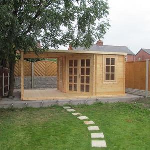

    Waterproofing under felt?
    I've just been thinking about that. I was originally going to lay it lengthways in 4 long pieces with overlaps between each, bonded with felt adhesive. However I now think laying it across the direction of flow would be better but would mean more joins Should I lay under felt ?
  3. B
    Hi, The summerhouse came with 4 big rolls of felt. I paid extra for their premium felt but I couldn't tell you what that means
  4. B
    Hi, I'm in the process of building a 5x3m summerhouse. It is in kit form and I am just at the roof stage. The roof is constructed of 20mm tongue and groove planks which is then to be coated in felt. The slope of the roof is 1 in 50 along the length (5m) and I am wondering would it be a...

    Garden Building with totally flat roof
    Run Firrings along the joists or at 90 degrees to? I couldn't run them at 90 degrees to, as the planks will sit in that direction. the joists are 5m long and I only have about 150mm to play with before I hit the 2.5m max height without planning permission.
  6. B
    Hi, I am in the process of building a garden Cabin / Shelter as in the picture below. All is going well now no thanks to the shoddy company who I bought it from Side note: NEVER EVER buy a building from Quick Gardens!!!! Anyhow as I am starting to construct the roof I have noticed...

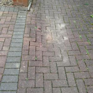

    Dip in Block paved drive
    Hi, It is heavy clay type soil underneath.
  10. B
    The drive has been down around 20yrs with no issue whatsoever but that really bad winter we had about 2/3 yrs ago (well it was v bad up here in the N.E) and we had compacted ice and snow on the drive for about 3 weeks, it happened after that, during the thaw. My neighbour has a similar dip...
  11. B
    Hi, How would I go about bringing this dip in my driveway (which occurred a couple of winters ago) back to a somewhat level surface without lifting the whole drive and relaying?? I am suspecting that this may not be possible. The area shown is a radius of around a metre, maybe a bit less...
