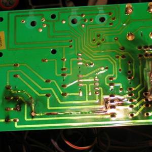

    Combi Problem
    A.M.D.G. Bertie, thanks for your reply. What can you say, it's installed in us. Turnued out to be a dirty venturi. You an ex Hill St man? Have my two up there just now. Thanks for the help. Gary. (A.M.D.G.)

    Combi Problem
    Thanks Agile. However, if I need e lecture on motovation & morality I have a really good priest who's only too willing. I really only needed to know if anyone can give me the advice I'm looking for. BTW the PCB is £85 & brand new. My old grandmother, God rest her, used to say, " If you...

    Combi Problem
    Yeah I know Gavinda, pretty silly poking around with the power on. Just laziness really. I can assure you it'll be going off when the new PCB is getting put in.

    Combi Problem
    Hi there, I have a Vokera 20 80 RS Flowmatic. I have been having some problems with getting a consistant temperature in the h/w. If you look at my recent previous post, you will see that I have already secured any leaks in the c/h system, repressurised the expansion cylinder, and bled the...
