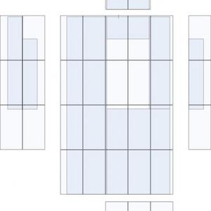

    Tiling - Wall layout
    Hi, I have made a few posts about tiling my ensuite, thanks so far for your help in answering my questions. I have uploaded images of the intended layout of each of the walls and a floorplan for the room. (sad I know, but I had time on my hands and got to do it properly!) Do you all...
