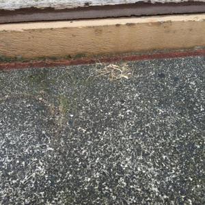

    Concrete garage roof repair (also used as balcony)
    Thanks for the replies on this. I've decided to remove the brickwork from around the edge of the balcony/roof, seal the roof using the liquid sealent that you paint on and cover with desking and balustrade. So, a couple more questions: If I drill hole in to the concrete to fix the...
    Hi, We have a garage attached to the rear of our house. The roof is used as a balcony. The garage is brick built with a concrete slab roof. Since we bought the house last year, the garage gets wet on the inside of the walls. I'm pretty sure it's the roof that's leaking but i'm not sure...

    decking onto concrete roof
    Hi, I'm not sure if what i want to do is possible or not so need a bit of advice on a couple of points: We have a garage at the back of the house with a concrete roof that is used as a balcony/patio. The roof is leaking into the garage at one side so I need to re-seal it somehow. Afteer...
