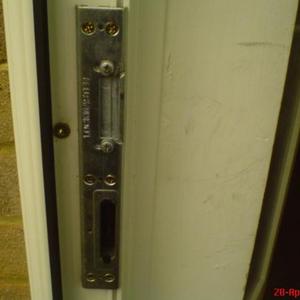

    LOCKMASTER front door will not lock
    Following on, looked today. These do not appear to be 'flag' hinges ! No allen key spot at bottom, only what seems to be an end bolt surrounded by a sort of black seal. Right in the centre of the hinges on the front is some adjustable screw (like an allen key but one of those more modern...

  6. W
    [/url] Thanks for advice. Will try during the week when i'm back at house. From memory, i think there's 3 flag hinges. presumbly i adjust all 3 the same. Also, i could not see a way of lowering or adjusting the plate . The reason i'm thinking the door hasn't dropped is that i visually...
  7. W
    This is a two hook, four bolt lockmaster set up. When closing door to leave house, although the door shuts ok (meaning no-one can get back in without a key), we cannot double lock. The mechanism works when pushing up the handle but the problem is the alignment of the central lock into the side...
