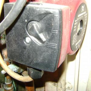

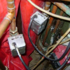

  17. F
    water too hot checklist
    here are some pics The little levers on top of the valves do not move at all when switching CH/HW off at the controller/programmer. Thought I'd include the pump in case its relevant
