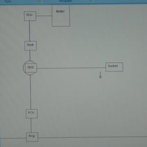

    Can I spur a spur?
    Thanks, little confused now though. Just looked behind the socket the current spur is taking it's power from and that only has a single cable as well, does that mean it's a spur (I can trace that cable to another socket then to the boiler) or am I dealing with a radial circuit?

    Think I'm going to have to Try and extend the ring main to the socket, not sure if it's possible, mainly because I'm not sure how to do it. Going to have to do some research.

    It would only ever be the combi boiler and the tumble dryer, would this be fine? At most additional to this there may be a Hoover attached as well
  4. W

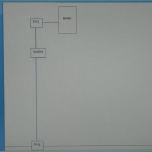

    Can I spur a spur?
    thats good going how the first picture was done by n-power when they fitted the boiler, they even signed the part p cert saying it was safe? I'll wire it up to the second picture, thanks for your help.

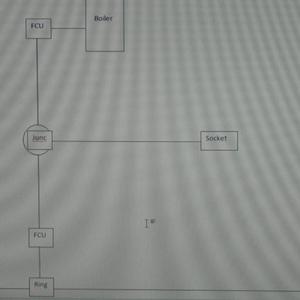

    Thought some images would help, the first one is how it is now: and the second how I'm thinking is the best way to add the socket.

    Thanks, not sure what was meant be the last comment. If the junction box which splits into 2 feeding the boiler and the socket separately is after the FCU doesnt this mean its on the load side?
  11. W
    Can I spur a spur?
    Ok, so back of the socket into a 13A FCU then in to the junction leading off to the boiler and the socket? using 2.5 cable throughout?
