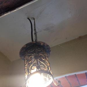

    How is my Victorian porch ceiling made?
    Highly scientific method i.e. knocking on it. Doesn't feel dense like plaster and lath, feels to me like a single wooden board. Looks like it too although I expect that doesn't come across in my ropy photo... You've got me there I must admit. I guess that date would make it Edwardian, then?
    Important not to over-estimate my mad DIY skillz chap :) Generally like to think I can fill any holes I make but if I knew how this lot went together I might attack with a bit more confidence... Appreciate the hints & tips as ever...
    Definitely wood! Lath and plaster would be (relatively) easy as you could knock a hole in it then fiill it afterwards. Not too sure I could get a good finish by cutting a hole in the wood and trying to fill it...
    Ah now there's an idea. As you can see the cable for the light simply sticks through the wood and has been secured with putty/filler. I'm installing a PIR which I think will be a bit destructive, so I wonder if it might be easier to remove the old ceiling and put up a new one. I just...
    Hello everyone, I live in a Victorian terrace built in 1903. It has a standard covered porch at the front. I'm looking to install a PIR onto the porch ceiling, which only measures about 2' x 2'. Can anyone offer any insight as to how the ceiling works, for want of a better phrase? I...
