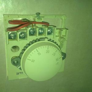

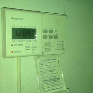

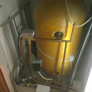

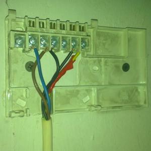

    Heating and Hot Water Controls Upgrade Advice
    No probs. I can see that replacing the current stat with a CM907 is possibly the cheapest and easiest way to do this. It's not a major problem having the hot water timer still in the airing cupboard, but it would be good to have them combined.
  2. S
    Cheers. Yep, I know the boiler ain't the best, but it's not been too bad for us. I thought that if I just replace the current thermostat with something like a CM907' I wouldn't need new wiring? Like I say, ideally I would replace the current stat with a combined heating/hot water and...
