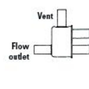

    Boiler above Hot Cylinder
    When the boiler is above the cylinder where should the Air Separator be sited? Does it go at Boiler height?

  19. C
    Sorry. I didn't make myself clear. The old boiler (and presumably the new) needs a bypass valve. The question is whether it should stay as a standard gate valve (cracked open) or an automatic valve.
  20. C
    So pump OK. I was expecting that an Air Separator was needed but hadn't come across the surge arrestor. More Googling. I also saw a set up with an automatic air vent on the highest point. I don't have this. A well known (and probably the largest) plumbing company in London also stated that I...
