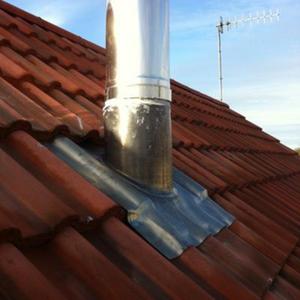

    Lead flashing or rubber boot for SS chimney exit?
    I'm not sure. The roof is newer than the stove/chimney. I assume the roofer would have put the correct stuff up... could you explain a bit more about where this red slate would be seen? Isn't the slate the bit on the slope of the roof, underneath the lead?
  2. T
    I certainly hope so. I got the official building regs form thingy when he installed the stove. Is there something in the photo that makes you doubt it?

  5. T
    Oh. Hmm, I think he has ordered the lead to be made up now... I suppose I could try and get him to cancel it. Hmm. If I wanted to remove the lead later couldn't we just break the seal and lift the lead over the top of the chimney again, the same way he got it on?
  6. T
    Looks like you're right! I had misunderstood him. The lead is welded into a shape so it forms a sleeve round the chimney, then he'll use lead sealant to make a seal between that and the SS.
  7. T
    The twit who fitted our wood burning stove cut the rubber boot too slack, so there is a few mm gap round it and rain comes down the side and into the house. I've asked the roofer who is working on the house to change it for a new one. He has suggested he could make up a lead flashing kit...
