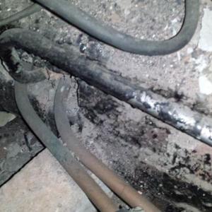

    Hi Daniel We have a baxi back boiler. Crawling around on the living room floor I think I can hear the slightest hum under the floorboards near the pipes that run up the side of the chimney. I was sure the pump was in the upstairs bedroom but I can only find two fat pipes coming up from down...

    Hi Guys I was just wondering how to tell what setup you have if you can't get access to pump, valves etc without pulling up carpet. If I put my hand on the pipe leading to the HW tank coil (when cold obv) I can feel the water being pumped through it if I have both CH & HW turned on yet if...
