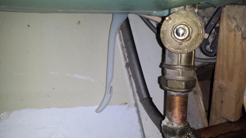

Hi Daniel
We have a baxi back boiler. Crawling around on the living room floor I think I can hear the slightest hum under the floorboards near the pipes that run up the side of the chimney. I was sure the pump was in the upstairs bedroom but I can only find two fat pipes coming up from down stairs leading off to the hot water tank in the next room and two thin pipes coming up from downstairs leading off to all the rads
this is the thickness of pipe for the HW tank coil
What you have is gravity HW and pumped heating.
The pump with the thin pipe is somewhere on side of chimney breast where the boiler is.
Maybe inside box over.
The valve next to tank, I can't remember what it called, I should know, i fitted many..... :-/
That's it, Cyltrol valve!
Daniel.

On gravity HW is the water pumped through the tank coil when CH is on? Is that the norm?
How can I silence the dreadful banging from the boiler when just asking for HW?
You risk damage to your boiler, as the banging is caused by bad circulation, etc and heat not being taken away from it to cylinder. If you have an electric immersion heater, use that until your engineer arrives.
I would tryto avoid using boiler alltogether, but certainly don't use hw if it causes banging.
As you have a baxi back boiler, it has an injecter tee so when HW is on only, the boiler come on, pump stay off, and the pipes from boiler to cylinder work on thermodynamics ( think it right? ), heat rise up and cold drop down, that why it is gravity.
Pump come on for heating and the injecter tee help gravity move a little quicker.
Might want to get the boiler serviced... It might be overheating on gravity only...possible Cyltrol valve seized....
Daniel.
