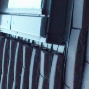

    edz flashing with ashmore tiles
    Hi all - in the process of fitting the flashing, have trimmed sponge so follows contours of underside of Marley ashmore tiles - we're not happy with the size of the gap from underside of tiles to flashing. as tile overlaps top of next tile down there is a good 20mm gap. Doesn't look brilliant...
