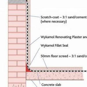

  11. J
    Damp at edge of floor?
    ideally this is what would be done: according to the wykamol product guide. My problem is that putting a new floor in isn't an option so i'm stuck without a 'fillet' and trying to put something in. so a couple of questions... 1. My plan is to use 'fillet seal' around the edges before...
  12. J
    Thanks for the reply. It looks like it's coming up although it's possible some is across from the wall as the adjoining wall is below ground level. I've installed an electro osmosis system but this wont be switched on for some time until i finished a couple more rooms. My plan is to keep the...
  13. J
    My front room (Victorian house) has a concrete floor with what looks like plastic dpm underneath. I've got some problems with penetrating damp in the walls so am going to use sulphate resisting backing render with aquastop tanking ontop. My question is about the floor edge. I have some...
