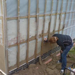

    I'll take more (better) photos tonight of what he's managed to do, and the construction thus far. I have not seen examples of his work, he was recommended to us by one of my girlfriend's friends. He did say he's not rendered on this type of construction before, at which point alarm bells...

    As in, attach another layer of mesh over the whole house. And then he's going to charge us another £1000 to do a third (base) coat. All seems very disappointing to me :( It's mesh on timber battens and counterbattens on a timber framed house. Here's a photo (I hope) so you can see what I mean:

    Just had a call from the guy who gave us the quote, he started the job today (I am at work). He says the house will need 'double meshing' as a single layer wont hold the render (?) and also he will need to do 3 coats instead of 2 :o Would that make sense? I've never heard of that before...
