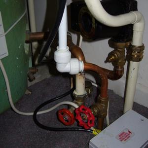

    valves in airing cupboard
    Yes I am trying to do this, emailed a few days ago but no answer, have just sent another to them.
  2. P
    There are no trvs in the system. Why can I turn that valve off? I am assuming it has never been off berore but can't guarantee that. Should mention that boiler is a conventional one, you probably know that, and is 18 years old but in good condition.
  3. P
    It's a Glow Worm economy plus.
  4. P
    LH valve has to go over 2 complete turns before fully open, RH one just over I complete turn. Is this right? Another post mentions similar problem with noisy pipes when hot water only is on and some replies say could be air trapped, poster asks how to bleed that, but no replies.
  5. P
    Sorry for delay in replying, at work, still am, so not sure how far valves knobs are on but will check when I get home. Thanks for the advice both of you appreciate it.
  6. P
    I had my heating system power flushed a few weeks ago, conventional boiler system. Two questions if anybody can help. When the hot water heating starts up, normally twice a day, there is alot of water 'rushing' and gurgling sounds from the pipework in the airing cupboard which it didn't use to...
