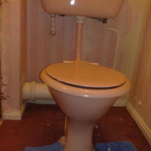

    Relocating Soil Pipe Venting
    An AAV is not an option as I previously said because its the only stack vent and the highest overflow would be the sink so defeats the object if it's the sink I'm trying to accomodate in the place of the soil pipe! Just wanna know feasibility of rerouting and if anyone has done similar. I...
  12. D
    Thanks for the reply. No I have no other open stack so can't fit an AAV. I've read the Building regs and even emailed building control who replied back: "I am sorry but we are unable to answer your querie as we can only comment on work not covered in the Building Regulations.The only...
  13. D
    Anyone any advice on what I can or can't do??
  14. D
    I hope I've done this right but I have attached a few of pictures to try and make it clearer. Excuse the crudity of the drawing. Option 1 Taking the soil pipe outside and up the exterior wall Option 2 Rerouting the soil pipe vent across to the side wall and up into the loft...

  19. D
    Hey thanks for the reply. I've been looking for that building regs documentation. Looks like I can reduce the pipe to 75mm. But doesn't seem to say whether it's ok to move the pipe outside or whether it's ok to reroute the pipe.
  20. D
    Ok Thanks for the reply! Just out of interest, what difference does it make if it's not vertical?
