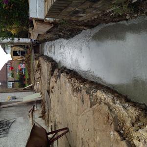

    Thanks for that Frank. I had a chat with the building inspector- he now wants me to got 2.1 meters deep as I have a blossom tree near me. Seems too much? I take it the foundation blocks are the thickness of 2 blocks + cavity. ?

    I had a brief chat with a building inspector who advised me that the area where I live the normal foundation depth is 1 Meter. Is this the actual depth of concrete of just excavation depth? Thanks[/list]
