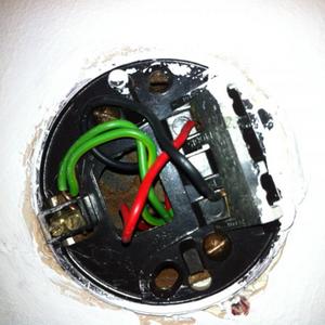

    Two earth wires - fitting new pendent light - help!
    I'm only confused with all this talk of CPCs to be honest! From the sounds of it I can simply remove the wires from the ceiling rose and attach directly to the new block with both earth wires attached to the earth terminal. ...I think! Cheers
  2. C
    Hi, The new fitting has a plastic block for connecting 3 wires - earth, live, neutral. What im saying is that the old fitting which was class I has the earth wire connected to the metal casing, which you wouldnt do with class II as far as im aware!
  3. C
    Hmm I am a little more confused now than when i started! The original fitting was class I but the new one is class II so i cannot rewire it the same way anyway. Any ideas?
  4. C
    Thanks, so is it OK to attach both earth wires to the same connection point in the new box? Prentice - i dont know what singles are...! the new fitment simply has a black tube to feed the wires too which leads to a white box with the three screw to attach the wires.
  5. C
    Hi all, This is my first attempt at DIY on light fittings and really want to make sure i'm doing everything 100% correct before electrocuting myself! I have taken down my old light fitting, which was metal, and i'm putting up a new one which is fully insulated. The old light fitting had...
