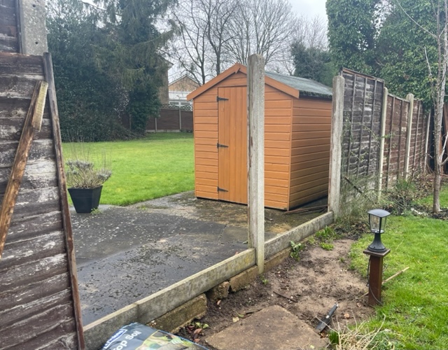

I need a few 1.8m wide overlap fence panels for an existing concrete post and timber panel fence arrangement. Have tried to slot in standard 6 feet (1.83m) panels but these are too big. The maximum size it can take is around 1.81m or 1.815m only.
I have tried to search online but can only find standard 1.83m panels being sold everywhere. Happy to wait if stock is an issue but haven't found a single supplier yet who supplies 1.8m wide panels. It is a large fence with concrete posts in very good condition so changing concrete posts to increase spacing is not a realistic option. Not looking forward to other options like trimming sides or opening+cutting a new fence panel to fit in the recess.

Thanks for a quick response. I need the overlap fence panels to match with existing ones. Have attached a photo to give an idea. Overall it is a long fence.

Can you cut 15mm off an end? Buying a saw is going to be cheaper than a special order panel.
Or neighbour bought standard panels and dismantled and cut them down then reassembled, but when the company had delivered them they said they would have made smaller ones for no extra cost. It might depend on how busy they are, but somewhere will do it.
The new standard panels feel very flimsy with end batons hardly 30-35mm wide. Trimming 15mm would make these very weak.
I am considering these 3 options
1. find a supplier who either makes 1.8m panels or can make these on order for a reasonable price
2. Buy standard 1.83m panels and open one end to cut down to size and reassemble
3. Buy good quality timber batons and repair existing panels by replacing the top and bottom horizontal edgings
Both Options 2 and 3 could involve a lot of work for me as need to do 7-8 panels. Option 3 is also not going to last as long as option 1 or 2. Option 1 would be ideal so still on it.
Any more ideas/suggestions are welcome.

Have reduced final end panels by several inches to fit the end dimension to posts /walls etc quite easily. Prise off apart panel end laths for reuse(obviously remove nails/staples) Position laths at required dimension and secure to each other with staples or flat headed wire nails suitably sized (if to long hammer over sharp end flat into wood lath. Use hand saw to cut off protruding bits of fencing wood.
