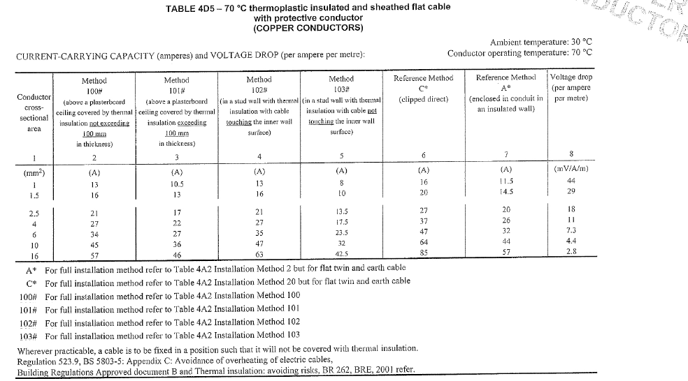

1 OR 1.5mm twin & earth cable for bathroom LED downlighters... discuss
Sorry, couldn't find the answer elsewhere... thanks
What did you expect to find?
The answer is in Tabe 4D5 of the Wiring Regulations.
You will notice that even under the most adverse installation conditions 1mm² is still adequate for a 6A circuit.
You may use cable larger than necessary if you wish.
This seems to have become a fashion - like using 10mm² for cookers where 4mm² would suffice.
As you mention downlights, you may find it better to use flexible cable smaller than 1mm².

It depends on what you have in stock, and how long is the total run, in general it is easier to get 1mm² wires into ceiling roses than 1.5mm² and since the ceiling rose is also a junction box and rated at 6 amp in the main lighting circuits are only 6 amp so really no need for 1.5mm² and even with 1.5mm² line and neutral the earth is still 1mm² so very little gain with earth loop impedance, only gain is volt drop so around 39 meters with 1mm² and 44 meters with 1.5mm² so not that much in it.
Does volt drop not depend on the current? How can you quote lengths without knowing how many lamps are used and the wattage?

6.9V (3% of 230). 1mm² is 44mV/A/m
6900mV ÷ 44 ÷ 3 = 52m. (52 ÷ 29 x 44 = 78)
6A would only be 26m.

Using the formula given in BS7671 to work out the correction and then going by the volt drop of 6.9 volts, so for a typical Ze of 0.35Ω I would expect a Zs of 1.5Ω installation method 100 Max permitted operating temp tp 70°C Rating factor Cg and Ca both 1 and as said Design current for circuit Ib 6 amp then Corrected mV/A/m = 39.3830374753452 and Volt drop = 6.9 and the Cable length meters = 29.2003886373653 I use a java script program so have been able to check the readings over the years so know it is not far out if any thing in fact it was you John many years ago who helped me test the program to ensure no errors.
In real terms I suppose with a 6 amp overload we should assume the lights are even spaced so we could be considering the Design current for circuit Ib to be 3 amp rather than 6 for working out volt drop, so at 3 amp we get 59.8245434024215 meters of 1 mm² cable before we hit the 6.9 volt drop. It is better than double because of the correction factor changes so Corrected mV/A/m = 38.4457593688363 and the Zs would be 2.65Ω.
In days gone by with fluorescent fittings being so dependent on voltage the 3% volt drop for lighting was important, but with the move from wire wound ballast to electronic and the change to LED lighting don't really need the 6.9 volt drop figure any more. And although we are told traditionally to allow for 60W per lamp that also is now not the case, my living room which is quite large is 50 watt total and the kitchen is 98W (A 6 foot tube 70W plus LED tube 28W) dinning room 30W total bedrooms 10W each and landing 18W bathroom 25W plus a couple of wall lights so whole house everything switched on is around 300 watt so 1.3 amp approx with every lamp turned on. So in real terms the design current of even 3 amp is over egging it, work it out at 1.5 amp and looking at 120 meters max length and still using 6.9 volt maximum volt drop.
Which means unless the owner does something really silly like convert a room into a planetarium with little lights set into the ceiling then 1 mm² is good enough for most houses even without splitting upper and lower floor.
